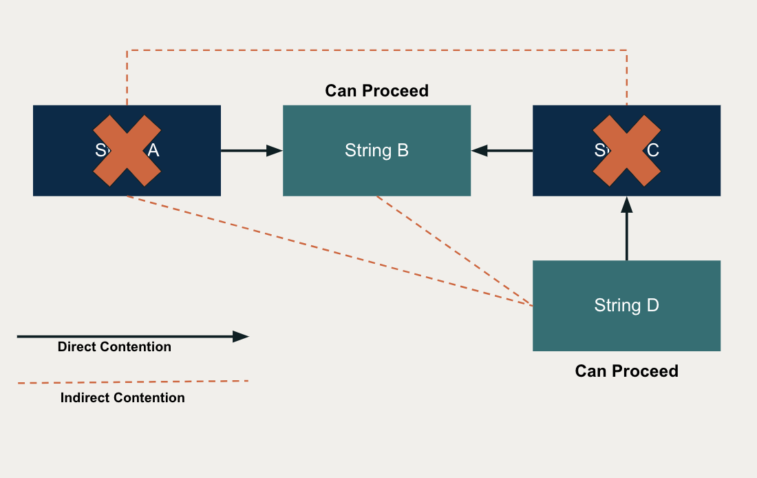

5.2.1.2 Indirect Contention
Two strings are in indirect contention if they are both in direct contention with at least one other string, but not with each other. It is also possible for multiple contention sets to overlap and be in contention with one another indirectly.
Figure 5-2: Direct and Indirect Contention Set Overview
Figure 5-2 provides a simple example of direct and indirect contention. In Figure 5-2, Strings A and B are in direct contention and Strings B and C are in direct contention, whereas Strings C and A are in indirect contention. That is, strings C and A both contend with String B, but not with one another. In the same figure, while Strings B and C are in direct contention, String C is also in contention with String D. Strings A and D are therefore also in indirect contention as are Strings B and D.
In some cases, an applicant that is in indirect contention and that is not the outright winner of a contention resolution process may still continue to the Application and Applicant Evaluation phase. This means that more than one application in the contention set could potentially proceed towards contracting.
For example, in the scenario pictured in Figure 5-2, if String B wins the contention resolution process, Strings A and C are eliminated but String D can proceed, as String D is not in direct contention with the winner and both strings can coexist in the DNS without risk of user confusion. These results are depicted in Figure 5-3.

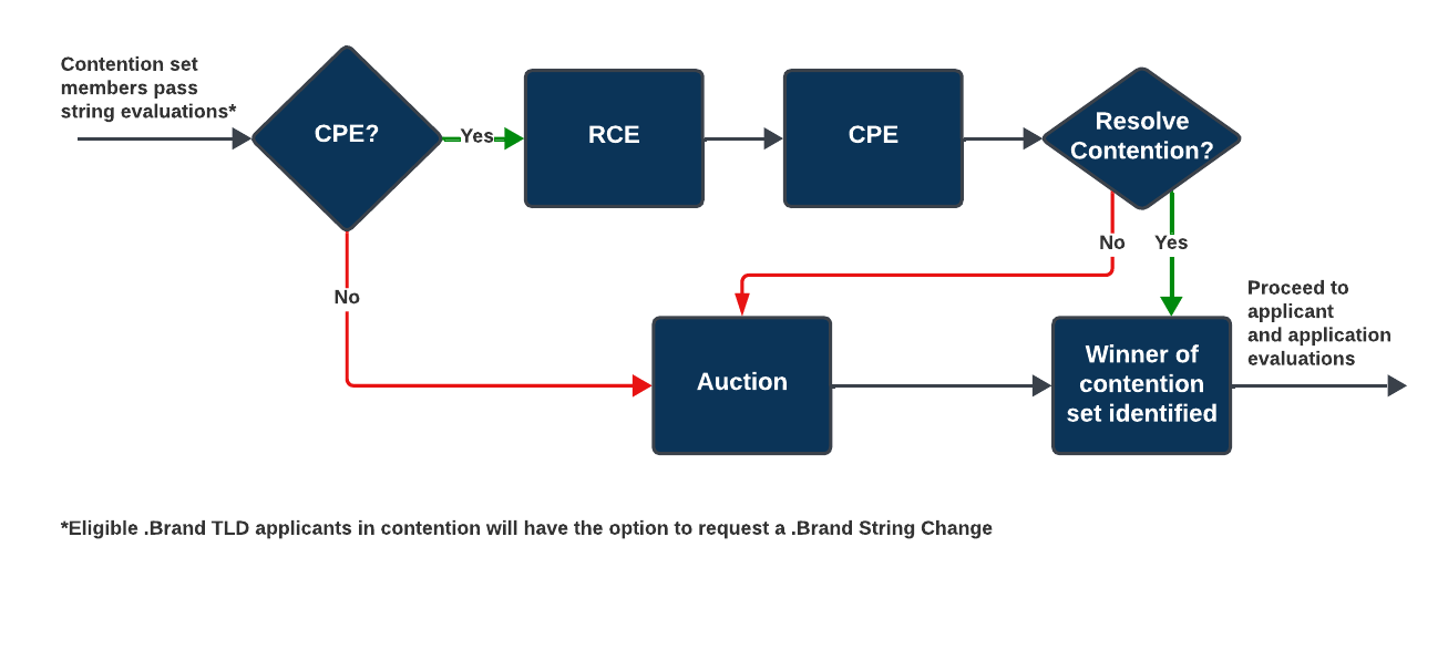

5.2.2 String Contention Resolution
Determining which applications in a contention set will proceed to the Application and Applicant Evaluation phase and potential contracting for the contested string is known as contention resolution.
Contention sets can be formed, changed, and resolved during the application process as a result of the processes described in Section 5.2.4 Contention Set Formation. For qualifying .Brand TLD applicants only, the option to submit a .Brand String Change to avoid contention (and therefore avoid resolution procedures) is also available (see Section 5.3 .Brand String Change Request).
Once contention sets are finalized, ICANN will administer two methods of contention resolution:
  • Community Priority Evaluation (CPE)4
  • An ICANN New gTLD Auction
Applicants prevailing in a contention resolution procedure, after completing applicable Application and Applicant Evaluations (see Module 6 Applicant Evaluation and Module 7 Application Evaluation), will proceed toward contracting of the applied-for gTLD. Alternative procedures apply to strings designated as high risk for Name Collision.5 The time required for contention resolution will vary because some contention sets may be resolved by more than one process. For example, in the case of two applicants for the same string prevailing in CPE, an auction between these applicants may be necessary to resolve contention. The outcomes of CPE and auction processes will be published on the New gTLD Program website.

5.4 Community Priority Evaluation
Community Priority Evaluation (CPE) is a method to resolve contention and is an option only available to Community Applications (see Section 7.1.2.1 Applications for Community gTLDs), a specialized application14 type. It will only occur if a Community Application is in contention and the applicant elects to pursue CPE. The evaluation is an analysis conducted by independent experts. Applications that successfully complete CPE will automatically prevail in contention, unless more than one application in a contention set passes the evaluation. In such cases, Community Applications successful in CPE will proceed to an ICANN New gTLD Auction.15
In the 2007 GNSO Final Report on the Introduction of New Generic Top-Level Domains, Implementation Guidance F states that “[i]f there is contention for strings, applicants may: i) resolve contention between them within a pre-established timeframe[;] ii) if there is no mutual agreement, a claim to support a community by one party will be a reason to award priority to that application.”16 In the Final Report on the new gTLD Subsequent Procedures Policy Development Process (SubPro PDP Final Report), the SubPro PDP Working Group affirmed “the continued prioritization of applications in contention sets that have passed Community Priority Evaluation (CPE).”17
CPE is an independent analysis conducted by a third-party expert panel. The panel’s role is to determine whether a Community Application fulfills the CPE criteria and should receive priority in the contention set. The scoring process looks at a set of criteria related to community establishment, the nexus between the community and applied-for string, registration policies, and community support. It is designed to identify qualified Community Applications while preventing false positives (awarding priority to unqualified applications for a coveted generic string) and false negatives (overlooking qualified Community Applications).
5.4.1 Eligibility for Community Priority Evaluation
As described in subsection Section 3.1.6 Application and String Types, an applicant will have the opportunity to designate its application as a Community Application18 at its sole discretion. An applicant designating its application as a Community Application19 is required to respond to a set of questions in the application form to provide relevant information about the community (see Appendix 1 Application Questions). The information provided by the applicant in response to the application questions will be used in CPE (and evaluated against the criteria described in Section 5.4.8 CPE Criteria).
In general, an applicant for a Community gTLD is expected to:
  • Demonstrate a relationship with an organized community, as well as show how that identified community (see Section 5.4.2 Definition of Community and Identified Community) engages with its members; awareness of the identified community between members; the established presence and external awareness of the identified community, and show that the identified community has longevity.
  • Have applied for a gTLD string strongly and specifically related to the identified community.
  • Have proposed dedicated registration policies for registrants in its proposed gTLD, commensurate with the purpose of the identified community.
  • Have its application endorsed in writing by one or more established institutions representing the identified community.
CPE will only occur if a Community Application is in contention (see Section 5.2 String Contention and Contention Resolution Procedures) and the Community Applicant opts to participate.20 Applicants submitting Community Applications will be given the opportunity to opt into CPE once all applications in a contention set meet the following eligibility criteria:
ICANN notes that the term “community” has evolved considerably from its Latin origin (“communitas” meaning “fellowship”), now emphasizing cohesion over mere commonality of interest. Although the SubPro PDP Final Report does not define community for purposes of CPE, it does note, in the context of community objections, that “a community should be interpreted broadly and will include, for example, an economic sector, a cultural community, or a linguistic community.”22
As there is no singular definition of community provided by the SubPro PDP Final Report nor a defined list of “eligible communities,” the CPE criteria employ measures that balance objectivity with flexibility, ensuring the criteria can accommodate the broad spectrum of ways that a community might be structured, managed, and viewed or supported by its members and outsiders.
The term “identified community,” used throughout this section, refers to the community that an applicant, in its Community Application, claims to represent or on whose behalf it claims to be applying for a Community gTLD.
Any applicant can claim a relationship to a community in its application and designate it as a Community Application, committing to operate the gTLD according to a set of Registry Agreement Community Registration Policies (Community Registration Policies) that will be enshrined in the respective Registry Agreement. However, in cases where a Community Application is in contention with other applications (whether community or another type), a third-party panel is used to verify the community claim by the applicant.23
Accordingly, the panel will verify, based on evidence from the applicant24 as well as the panel’s own evaluation,25 whether an applicant’s claim on a community meets the CPE criteria defined in this Guidebook and whether the application is eligible to receive priority in a contention set based on its score.26
5.4.3 Conditional Fees for Community Priority Evaluation
Once the conditions in Section 5.4.1 Eligibility for Community Priority Evaluation are met, any applicant with a Community Application within a contention set will be notified of the opportunity to participate in CPE and will be requested to submit the required fees within 30 days of notification transmission (see Section 3.3 Fees and Payments). If the fees are not received within 30 days, the applicant will forfeit the opportunity to participate in CPE and will proceed to contention set resolution (see Section 5.2 String Contention and Contention Resolution).
Applications will be given priority numbers, which will be used to determine the general order of the release of evaluation results (as described in Order of Application Processing and Prioritization Draw). However, processing for CPE will largely be dictated by when an application and contention set become eligible, as noted above. Timing for CPE is also dependent upon Registry Commitment Evaluation (see Section 5.4.5 Community Registration Policies and Registry Commitment Evaluation).
Applicants who designate their application as a Community Application will be asked to answer a series of questions specific to Community Applications.27 The answers to these questions will be evaluated if the applicant elects to participate in CPE.
5.4.5 Evaluation of Community Registration Policies in Community Priority Evaluation
When submitting a Community Application, applicants must propose Community Registration Policies for inclusion in Specification 12 of the applicable Registry Agreements.28 The CPE Panel will evaluate the approved Community Registration Policies (see Section 7.8.4) for consistency with the community objective of the application (see Section 5.4.8.3 Criterion 3: Registration Policies).
This differs from the Registry Commitment Evaluation (RCE) (see Section 7.8.3.2), which verifies that applicant-proposed policies for inclusion in the applicable Registry Agreement are enforceable and compatible with the ICANN Bylaws. See instructions for Question Set 11 Registry Voluntary Commitments for the detailed requirements that guide the drafting approach of proposed Community Registration Policies that will be evaluated through the RCE.
Applicants should be aware that, absent extraordinary circumstances, RCE is estimated to take 60 to 90 days, and occurs before CPE begins.
5.4.6 Role of the Community Priority Evaluation Panel
CPE will be performed by a third-party expert panel appointed by ICANN. The panel’s role is to determine whether a Community Application fulfills the CPE criteria and receives priority over other applications in the contention set. The applicant is expected to provide information and evidence about its identified community in its application (see Question Set 7 Community gTLDs). In making its determination, the panel will review the applicant’s responses to the application questions to ensure all elements of the application are supported by evidence.
The panel may conduct limited independent research deemed necessary to evaluate the application according to the criteria and verify the information provided by the applicant. The panel is expected to focus its limited independent research on the fact-checking required to verify information provided by the applicant. Additionally, as part of this research, the panel may consult with relevant community-related experts to gain insight into highly specialized or localized communities. The guidelines for each criterion in Section 5.4.8 CPE Criteria allow for the panel to consider how a criterion should be evaluated in the context of different types of communities.29
If the panel conducts limited independent research or consults with community experts, it must disclose the results of this research to the applicant and include a citation or link to such research in its evaluation. The applicant will have 30 days to respond before the evaluation decision is rendered. When conducting any such research, panelists are cautioned not to assume an advocacy role either for or against the applicant or application.
Additionally, panelists may issue Clarifying Questions and engage in written dialogue with applicants with applications undergoing CPE, as well as those that have submitted letters of opposition to Community Applications, in order to address potential issues (see Section 5.4.6.1 CPE Clarifying Questions).
The panel may issue CPE Clarifying Questions30 to applicants for applications participating in CPE. Clarifying Questions may also be directed to a person or entity that submitted a letter of opposition to a CPE applicant. The applicant, or those who submitted a letter of opposition, will have 21 days to respond from the day after receiving a clarifying question. As described in Section 5.4.6 Role of the CPE Panel, the panel may conduct limited independent research deemed necessary to evaluate the application, including for the preparation and issuing of Clarifying Questions.
5.4.6.2 Challenging CPE
If the panel determines that the application has not met the CPE criteria and the applicant believes there is a factual or procedural error, the applicant may initiate an Evaluation Challenge proceeding within 21 days from the date of transmission of the evaluation determination (see Section 1.2.14.2 Evaluation Challenges). The same CPE provider will review the challenge, using a different set of panelists to form a Challenge Panel, when practicable. If the Challenge Panel finds a factual, procedural, or system error, the application will be reevaluated by the Challenge Panel with those findings in mind. If no error is found, the application will continue to the next stage in the process of contention resolution. There are no additional fees associated with an Evaluation Challenge proceeding.
5.4.7 Community Priority Evaluation Scoring
The CPE Panel will review and score the Community Application against the four CPE criteria. An application must achieve a score of at least 75% (12 out of 16 points) to prevail in CPE. The sequence of the criteria reflects the order in which they will be assessed by the panel. The utmost care has been taken to avoid any "double-counting"; any negative aspect found in assessing an application for a criterion should only be counted once and should not affect the assessment for other criteria.
The scoring process is designed to identify qualified Community Applications, while preventing both “false positives” (awarding undue priority to an application that refers to a “community” construed merely to get a highly desired generic word as a gTLD string) and “false negatives” (not awarding priority to a qualified Community Application). This calls for a holistic approach, taking multiple criteria into account, as reflected in the process. The panel scores applications based on information provided in the application, plus other relevant information available, such as: responses to CPE Clarifying Questions, application comments, letters of support or opposition, or any limited research conducted by the panel, such as verifying information provided by the applicant with public information regarding the identified community.
A qualified Community Application receives priority over all directly competing applications, allowing it to advance while others cannot. This underscores the strict qualification criteria described below. A panel’s failure to award community priority does not imply the community is inadequate or invalid; it simply indicates the application does not qualify to supersede all other contenders.
If a single Community Application in a contention set is found to meet the CPE criteria, that application will prevail and may proceed to the next step in the application process, subject to meeting all other Program requirements. Other applications in the contention set will be ineligible to proceed at that time.31
If more than one Community Application in a contention set is found to meet the criteria, these applications will proceed to an ICANN auction, while other applications in the contention set will be ineligible to proceed. If none of the Community Applications (as there could be more than one) in a contention set meet the CPE criteria,32 then all of the applications in the contention set will proceed to an ICANN auction (see Section 5.2 String Contention and Contention Resolution).
ICANN anticipates that the CPE process will take approximately 180 days.
